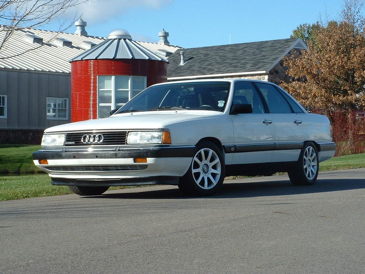

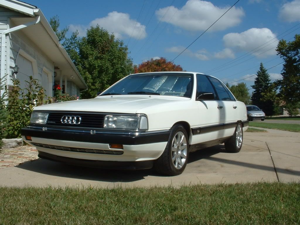

My name is Stephen and here's my 1986 Audi 5000 turbo quattro:

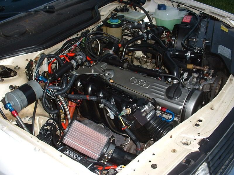

Engine bay pictures, 2.2 liter MC with Megasquirt EFI:

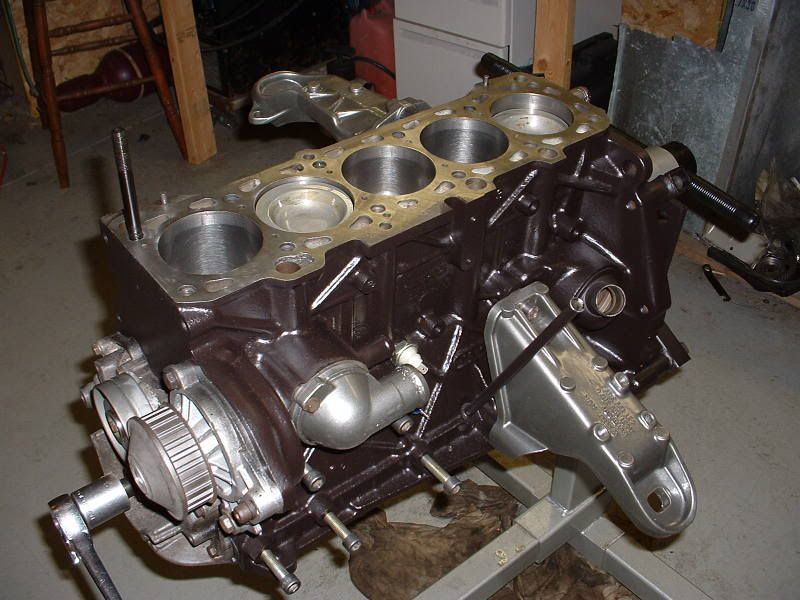

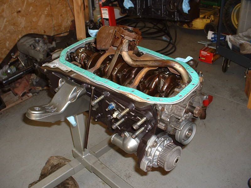

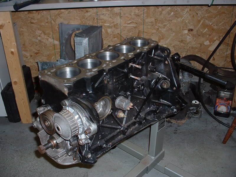

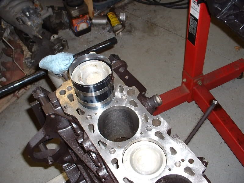

Some pics of the engine rebuild. Freshly tanked and honed MC block:

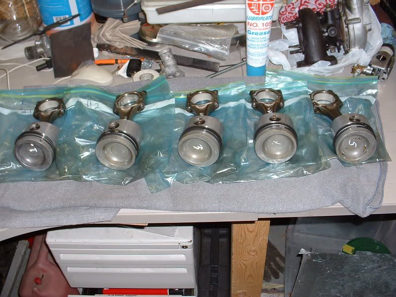

Cleaned up MC pistons with new rod bolts and wristpin bushings:

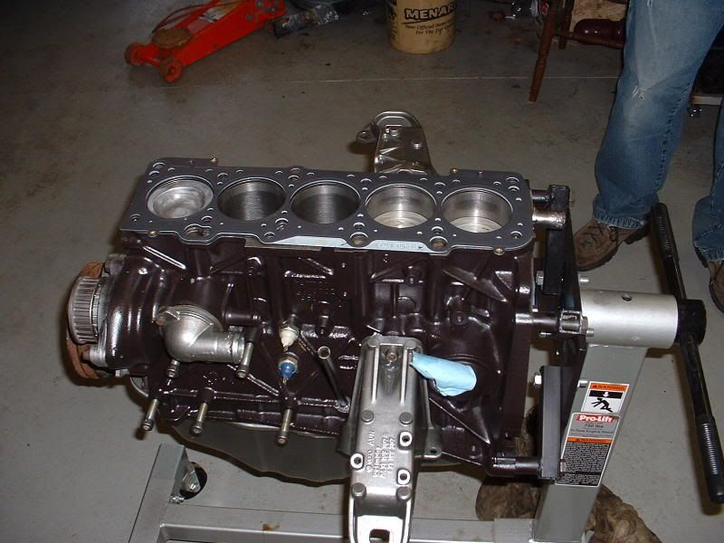

Installing new pistons:
New pistons installed:
New water pump, idler pulley, Raceware headstuds, powdercoated engine mounts and thermostadt cover installed:
20vt headgasket:
20vt windage tray installed:

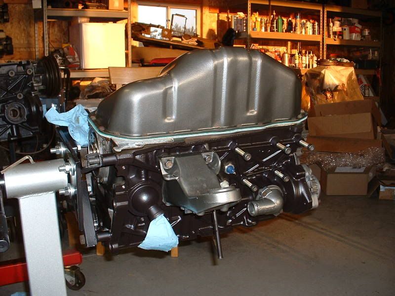

Powdercoated oil pan installed:

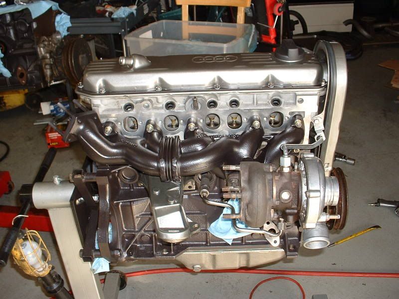

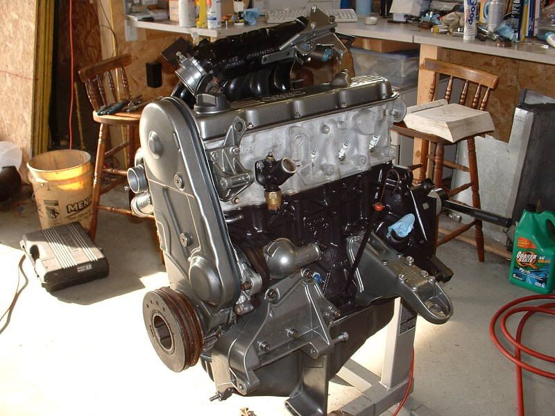

Cylinder head and exhaust manifold on:

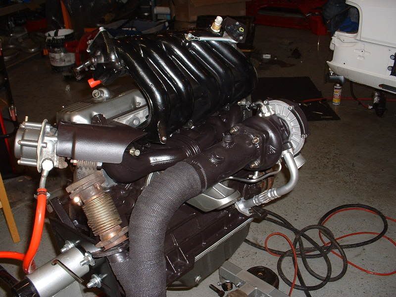

Powdercoated valve cover, timing belt cover and intake manifold on:
Test fitting 3 inch downpipe:
Installing rebuilt wastegate:

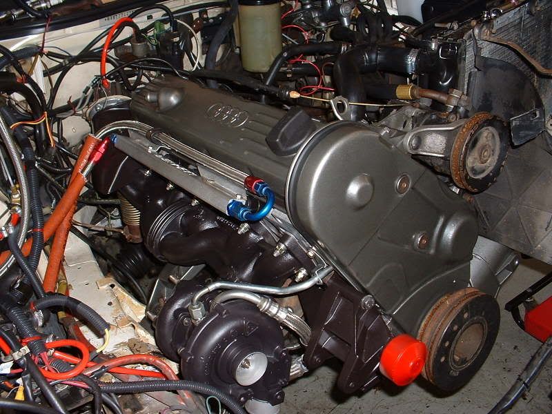

Hooking up oil and coolant lines:
Finished. Ready to be installed:
Engine in...almost done.
Thats it for now. Hope you enjoyed my work.

By the way, what have you done to the engine...?
The cylinders look like you have "just" had them honed or them resurfaced with a Flexhone!?
It´s marvellous, that after - and I´ve seen it myself -
350 000 km / 220 000 miles - there are almost no wear at all in the top of the cylinders! :)

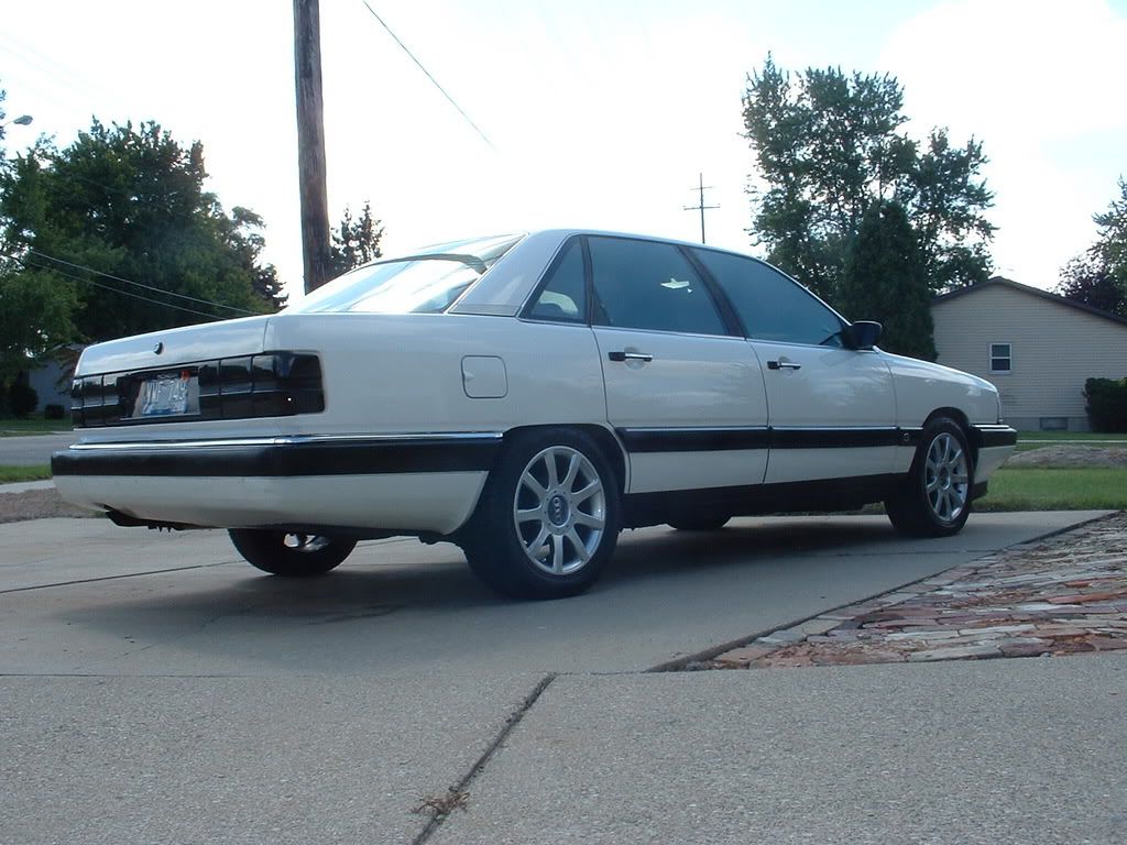

The car looks so "low" - are there an aftermarket set instead of the one from AUDI on the car now..? :-D
Kindest regards
Tony
SteveAngry
Beitrag von SteveAngry »
4Circles hat geschrieben: By the way, what have you done to the engine...?
Kindest regards
Tony
Hi Tony.
The cylinders were rehoned.
The original engine had 300,000+ miles on it. I could still see the original cross hatching...
For suspension I am running Bilstein sport struts with Eibach springs from a S4/S6.
Steve
